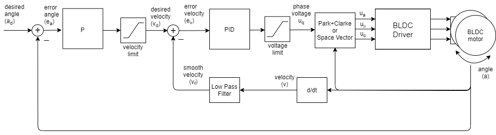

Position motion control
Now when we have the velocity control loop explained we can build our position control loop in cascade as shown on the image.
When we have target angle we want to achieve, we will use the P controller to calculate necessary velocity we need and then the velocity loop will calculate the necessary voltage votage_q to achieve both velocity and angle that we want.
The position P controller is implemented in positionP() function:
