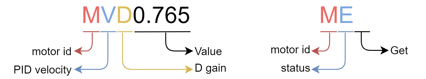

What happens when user sends a command?
When the commander received the string:
It first checks the command id, identifies its M and sends the remaining string to the motor handling callback. Then the motor callback checks what is the coommand id, finds V and sends the remaining string to the PID velocity callbacK. Then the PID velocity callback scans the command id and finds it is the D, so derivative gain and sets the value.
CommanderMotor callback (cmd id M )PID callback (cmd id V )
The other example is if the commander receives:
First id that it finds is O, which is for example motor. It calls the callback that is assigned to this command (which is in this case motor callback) with the string remaining string. Then the motor callback finds the command E and knows its the status (enabled/disabled) either getting or getting. It checks the value and sees that the value is empty, which means the user has sent a get request.
CommanderMotor callback (cmd id O )
